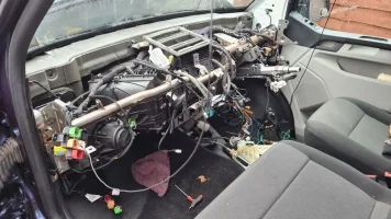

I only took out 3 screws under the glove box struggled to line the panel back up to screw them back in and caused a fault on my airbag. That would give me nightmaresLost a quid behind the dash!! But in all seriousness... I have undertaken installing AC and this is where we are at so far
....and then you found the missing quid in the door pocket!!! Actually, that's a really useful reference pic for the forum. Thank youLost a quid behind the dash!! But in all seriousness... I have undertaken installing AC and this is where we are at so far
I'll be writing a post about the process soon....and then you found the missing quid in the door pocket!!! Actually, that's a really useful reference pic for the forum. Thank you
Key thing to watch is making sure you don't reconnect or turn the ignition on whilst the airbag connections are undone or this will cause an issue that has to be cleared by VCDSI only took out 3 screws under the glove box struggled to line the panel back up to screw them back in and caused a fault on my airbag. That would give me nightmares
