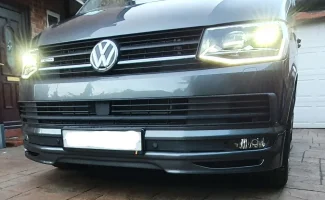

The afternoon hasn't gone to plan. The ARB has to be dropped before I can get the springs out to adjust and one of the M8 spline bolts holding the ends on was torquing out as I tried to undo it. When it had its pre-MOT service last week they did mention that they found one of the ARB bolts needed nipping up and I bet they've used an air wrench to do it. The inside splines aren't completely rounded but the bit is slipping and, given previous problems I've had with one of these that snapped, I've called it a day. I'm going to have to return to this when I've got a full day ahead of me without needing the van the next day and in the meantime order another set of bolts. I don't want this to snap again and have to drill it out so I may have to take it somewhere and get them to change the bolts, then I get to take out freshly installed ones. Disappointing.Decided to take today off as it looks like I’ll be working next weekend and as it was a cracking sunny day decided to get on with fitting my THQ lights. Went much smoother than I thought, the two awkward clips at the sides didn’t cause too much of a problem and the whole job from start to finish took under 2 hrs doing it on my own. The main problem I had was working out how to unclip the old headlights.
Big thanks to everyone who has put info about how they did it and shared their problems, it was only through this that I was able to carry it out so easily.
One thing I did slightly differently from what I’ve read, I didn’t completely remove the bumper, I unclipped it and pulled it forward a few inches to rest on an old pillow meaning I could leave all the wiring in place.
Now to grab something quick to eat and then get on with raising the rear B14s.
What's the chance that scratch is a piece of plastic swarf on the inside?The afternoon hasn't gone to plan. The ARB has to be dropped before I can get the springs out to adjust and one of the M10 spline bolts holding the ends on was torquing out as I tried to undo it. When it had its pre-MOT service last week they did mention that they found one of the ARB bolts needed nipping up and I bet they've used an air wrench to do it. The inside splines aren't completely rounded but the bit is slipping and, given previous problems I've had with one of these that snapped, I've called it a day. I'm going to have to return to this when I've got a full day ahead of me without needing the van the next day and in the meantime order another set of bolts. I don't want this to snap again and have to drill it out so I may have to take it somewhere and get them to change the bolts, then I get to take out freshly installed ones. Disappointing.
Then I went to put the van away in the garage and noticed that one of the headlights had a wiggly scratch on the INSIDE of the lens. Don't suppose it's worth going through all the bumper off procedure again to send it back under warranty, but it's taken the shine off it so to speak.
