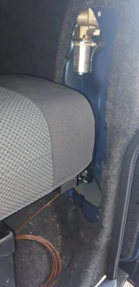

Fitted power latching kit to the nearside slider of my Camper, as supplied by @Pauly . He certainly knows his stuff and offered some great advice in advance of the install to my converted van. :thumbsup:
In addition to the significant noise reduction when closing the door, it no longer feels as though I am going to rip the handle off when closing, due to the additional weight of a Loc-8 table - my other favourite door mod.
I chose to cut-out the inspection panel (which conversion company had carpeted over) to allow easy future access if needed - but a simple enough thing to finish off nicely once the can of trimfix arrives in the post.
Very pleased with the result - I should have done this ages ago!!!

Well done! I miss the power latching on my Cali
@Pauly - Yes! Well pleased... and appreciate the advice - install would have been about 15 minutes quicker if I had been able to count higher than 8 on my own...
Still, I made up for the lost drinking time when I got to my local pub! So the day is definitely a success!
@JOG - might be worth giving Pauly a shout; I am guessing that others must have retrofitted to Cali's - and know the tricks to install more easily?
For part of my install today I used some plastic-coated garden wire and a few bits of electrical tape to pull-through cables under my flooring to the passenger seat... I was in a rush to get to the pub (hence my comment to Pauly about me only counting to 8; I missed a couple of pins when looking at one of the connector blocks). Using garden wire to pull cable was much easier and quicker than actually bothering to take things apart! :whistle:
