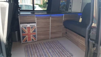

Fitted kitchen under counter led strip light. Like the one now flitted as an option on new T6 VW California
Didn't hardwire it in yet, only powered off 12v socket, want to make sure its worth it before drilling into cupboard to fit on/off switch20190328_113307.jpg 20190328_113318.jpg
Fitted kitchen under counter led strip light. Like the one now flitted to new T6 VW California
Didn't hardwire it in yet, only powered off 12v socket, want to make sure its worth it before drilling into cupboard to fit on/off switchView attachment 40041 View attachment 40040
Had quite good feed back from people who have it fitted at factory Only cost £18
