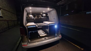

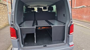

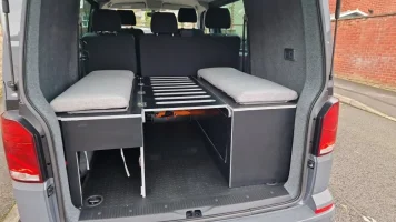

That looks smart
Been looking at the same kind of thing, can you tell me if VF units are built around a wooden frame or are the furniture boards just fixed together with brackets ?
also are you able to secure them to to lashing points
thanks
@Panch think flat pack furniture cnc cut lightweight ply. They do need a good sanding. Ran out of light today to investigate fixing them to the lashing points. Will update when I sus it out.
cheers @Fozzer ..it’s definitely the way I want to go. It would work with carrying my MTB between the two side units

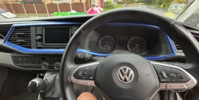

@laidbackian what paint or product did you use?
After removing the trims, I gave them a good clean clean in warm soapy water, followed with a final clean with IPA. Then masked them, which is the most time consuming part of the process, before applying:
  • 2 x coats of plastic primer.
  • 2 x coats of paint.
  • 2 x coats of clear lacquer.
The colour I choose was to match the furniture in the rear, and it took a couple of days prep and waiting for the layers to dry, before applying the next. Here are the products I used.

Many thanks, looks really good
