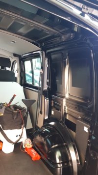

Had a spare and a dry day so i was able to pop off the panels and roof in the rear ready to insulate. Also put some wires in for some cargo lights below the bed and some into the tailgate with a fishwire for the future. Bit of PITA to get round the rubber but thanks to the forum, I was able to sort it.
Q-Do the exsisting sticky panels need removing before fitting the dodo panel pads????

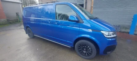

Finally finished my diesel heater install today on our T6.1, I dropped the tank cut off the nipple on top of the fuel pump connected my push fitting which I bought off EBay, connected fuel line and clipped it along the fuel tank fired the diesel heater up whilst the tank was still on the ground to test the fittings. Refitted fuel tank, adblue pipes, side and tank covers and finally finished the project and I’m completely cream crackered.
