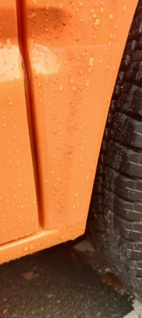

Replaced the stone chip sticker after having my dents repaired:

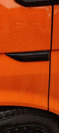

And fitted some new side repeaters:

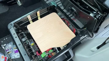

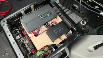

More messing about under the passenger seat for my audio upgrade…
Eventually settled on this solution - plywood and right angle brackets bolted through existing holes in the top of the seat base on either side.
The Audison SR5.600 and the Helix DSP Mk2 Mini fit OK and I’ve tried to do some cable management, used ferrules and fused the amp power at both ends and the 12v ignition supply at the add a fuse and just before the Helix.
Still no ETA on the subwoofer enclosures so am abit stuck now but still got to look at the DSP software and amp knobs as I haven’t adjusted anything yet.
Somewhat disappointed that I now can’t fit the rear plastic seat base cover because some idiot put a bit of plywood in the way. :whistle:
Also can’t get to the amp controls with the seat in place either.
And I’m not happy with the gauge of speaker wire I have used to bring the high level speaker outputs from the headunit - it is too heavy which means the ferrules that fit the wire are too big to fit into the screw terminals on the DSP and vice versa :rolleyes:
So I might end up ripping it all out and starting again….

As my dear departed dad would say, "if in doubt, pull it out", still not sure what he was talking about....

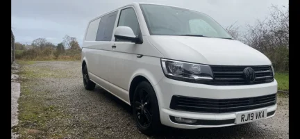

Hi, the bumper was from travlin-lite. It was meant to be a bundle but due to stocking issues I ended getting the gloss inserts from Transporter HQ (upper) and Vee-dub (lower). I thought the price seem pretty competitive from travlin-lite and happy with the quality too.
