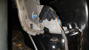

Temporarily fixed my handbrake after the lowering kit bracket sheared in half and left me without a functioning handbrake. I took it off the bracket and mounted it back on the original seat mount. I needed to use a clamp to deactivate the handbrake warning switch as it beeped at me - I couldn't see where/how to mount the switch and didn't have time to find out. It got us back from the Lake District so I'm happy with that. You can see the sheared lowering bracket in the picture - no idea how that broke?
I'll need to find out how/where the microswitch fits so if any of you geniuses on here can help me out I'd be very pleased. Thanks.
Edit: credit where it is due. I emailed Combe Valley Campers where I bought the bracket from notifying them that mine had broken and asked if they’d had any others do the same since it was no longer an item they stocked. Leigh, the owner, replied saying they’d had one other brake which they had offered to replace with one from another supplier free of charge. He offered the same to me offering me the unit that Just Kampers sell. If I supplied an address he’d have one shipped to me. Within the hour I had notification from DHL that they had my parcel and it would be delivered tomorrow. The reason he doesn’t see the bracket is that he couldn’t match the price others were offering them at. I’d say that was excellent service from a small business. Thanks Leigh
I found a view of the switch on the Combe Valley campers installation video. I'll see if I can refit it there tomorrow.
