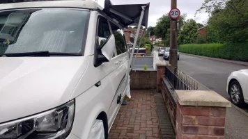

Noticed I had a lot of wind noise the other day on the motorway and found that our vanmax poptop wasn't closing behind the wind deflector.
Quick message with our converter and we fixed it today; loosened the bolts one side at a time and pulled the hinges backwards (the mounting frame is slotted)
