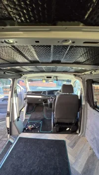

I managed to find some time to build a cover for the front of the seats as it bugs me that it’s open both visually and for items to roll under the seats.
When I fitted the back covers I installed some cabling so I could fit some additional lighting as the footwell lights are so poor as standard and I want to be able to control them from the rear switch button for when sleeping in the van.
I used a cardboard template to start with and ensured there was enough gap at the bottom to allow the front mat to be removed a if needs be.
I wanted to nut and bolt them on as I didn’t want to see any screws, but with the sub under the drivers seat there simply wasn’t access to reach to back of the hole. I ended up using a trick that I did with the van shades where a ‘V’ is cut out to cover the screw once fitted. It came out better than expected if I’m honest and really happy with the results:

Hi @Kev.O if you could share the dimensions that would be most appreciated. Fitting covers to the front seat is a job I've been meaning to do for a while, but never got round to. MTIA.
Hi, I realise they are a little hard to see but I wrote them on the wood. The height is 13cm, 39cm wide at the top and 36.5cm at the bottom. This allows a mat to go under the bottom of the cover and the reason I only went 13cm high is because the metal isn’t flat, any higher and there would be a larger gap as the wood pivots in the middle. I also put a second piece of fabric on the back at the top. This helps to cover the slightly larger gap caused by the above when putting the screws in the middle of the wood.
