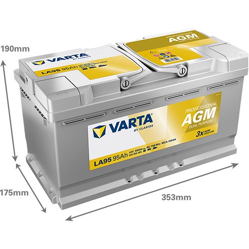

Keep in mind when pricing up that 100ah AGM == 50ah LiFePo.
Those are not silly money anymore
For example these are all around the £170 mark, in fact the LiFePo are slightly cheaper:
Compared with a good brand AGM:
They're also a lot smaller than the equivalent AGM so easier to fit, and the decent brands you can fit a second later in parallel if you find you need more.
That 50% rule gets trotted out a lot on this forum, and you can see where it came from historically, but the pure "100aH AGM == 50Ah LifePo" is not actually true with any half-decent modern LA battery. I've explained this before in this post:
The OP has made it very clear that budget is a prime consideration, so an AGM is the most obvious contender unless his power requirements specifically demand a lithium.
Depends on how heavy you are using your battery, and the OP hasn't indicated how much they are using it.
The 50% rule certainly does count if the bank is in heavy use. On the narrowboat we used to have to replace 4 x 110aH batteries in under 2 years before we had the gauge fitted, now it's been 4 years and they are still going strong. Granted that bank is being taken down by heavy use 6 days a week for most of the year but it does have an effect. If you're running the battery close to low every night you are away using a CPAP machine for instance that might be a consideration.
