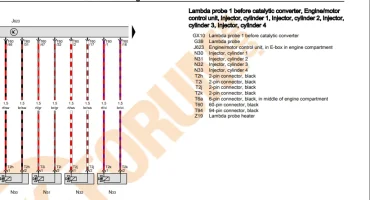

Agreed, no fuel into cylinders. Indeed the ECU doesn't even command the injectors to open.the data posted above shows the Engine ECU not commanding the injectors to open? - so no fuel is the issue.
But, where are fault codes? Not monitored?im thinking the injector feed via Engine ECU is the problem. - no power to injectors?
