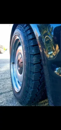

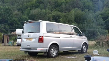

I can't answer that question@alter but where in Italy are you? I'm based in Campania and running 6,5J x 16 5x120 65,1 ET51 steel wheels and BF-Goodrich 235 / 70R16 All Terrain T / A KO2 104 / 101S on my T30.
We need extra rubber round here because the roads are so poor and they are good for excursions into the mountains in Lazio and Abruzzo.
In use, there is little bit of tyre hum but it's barely noticeable and I've noticed no effect on fuel economy. It's a 6% increase in tire diameter so it doesn't pick up as fast which is only a problem for overtaking which I don't do very often! I'll be getting it remapped when back in the UK next so that ought to alleviate that problem.
