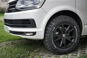

Here is my setup. I have 245/65 17 on my T6 4motion (standard height). This size fits perfect (over original 235/55 17) in my opinion. No rubbing anywhere. Wheels are oem Amarok 17x8J et49 model "ARAGUA", sandblasted and powder coated in matt black.

Looking to fit some 215/65 R16 BF Goodrich tyres to my T6 Kombi in the next week. The standard steel wheels I have are silver and starting to show rusting, so have been trying to source some new black 16" steel wheels. I cannot find any online, can anyone advise an online seller?

... I also had silver rims, I painted them in black ... very simple ..
