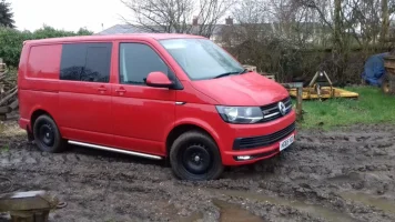

Just to give you an idea of what it looks like this is a 235/55/R18 on standard T30 4Motion suspension and no spacers:
I think because of the camera angle, the gap looks much bigger than it does when you look at it normally.

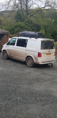

I’m currently on 225/45r18 and I want some AT as I used to have them on my truck.
My T6 is standard so was wondering what size tyres could I get away with to fill the massive gap between the wheel and arch........
This is keeping me awake at night haha PLEASE HELP
Thanks in advance
AJ View attachment 65730View attachment 65731View attachment 65732
Those are tiny tyres (225/45/18) in terms of radius/circumference, I don't think I've seen anybody on this forum with such small tyres?
100% 235/55/18 They hit the sweet spot imo in terms of every aspect of tyre selection & availability for a T6 on 18" wheels
Nice, very nice. The gap looks so much less. Can I ask out of curiosity how come you went 55 and not 60?
I only bought my van last week and that’s what was on it, I agree they look tiny hence why I’m desperate to get bigger tyres.

Certainly, I didn't want to change the gear ratios and speedo reading too much, my tyres now have a rolling circumference (the important bit!) of 3.5% greater than OE.
I can live with that, but I didn't want to go any higher because it can affect the drivability of the van. Mine is manual and 6th gear is plenty high enough, I wouldn't want it raised further by bigger tyres.
I went with Nokian Weatherproof, great in the wet (EU grade A for wet braking) and a good all round tyre for me. As you can see I go on muddy fields every week in winter, they're far more capable than they look. Tyres are a huge subject and it all depends what you want from them!
