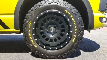

Running BFG 245/65/17 on these beauties.
A little more road noise over standard commercial tyres but if you sound deaden properly you will hardly notice them.
Very impressed with the all round performance of the tyre. Stable at speed, corners well and that grip is incredible on the loose and slippery stuff.
You won't be dissappointed. Oh and you can colour code the lettering if you feel inclined
If these tyres are fitted to standard VW 17" alloy even with a 35mm lift spring you will get a tiny amount of rub on full lock. Nothing of concern, but to will rub. ET of 40 is perfect, stops rubbing and the wheel sits a little further out which looks less like a roller skate and a little meaner.

What suspension are you running? Is that lifted?
Eibach 35mm pro lift kit. That has the B6 comfort dampers which have a little longer piston travel for lift springs. Not essential as the springs can be used with standard dampers but if you want to go exploring off road then the damper upgrade is the best set up. Very stable at speed, comfortable around town and performs well off road.
