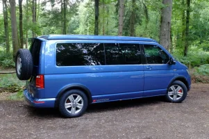

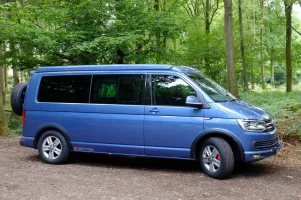

Yeah but that was just for aesthetics. 25mm front, 40mm back. Will probably swap the rears for 35mm at some point.
.... how could you fit the 235 / 70r16? ... do you have this homologated size on the documents? ... the tires are right on the original 16 wheels? ... and without spacers they don't rub anywhere? .. . regards
