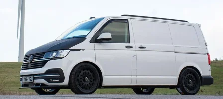

Any reason why?? Not a good idea?
I am mental :confused:
I liked them but just didn't like the look of the van in 'swamper' mode so have decided, because I preferred the look, to revert to lowered with 19s or 20s but this time spend some money on decent coilovers rather than cheap cobra lowering springs.
