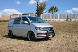

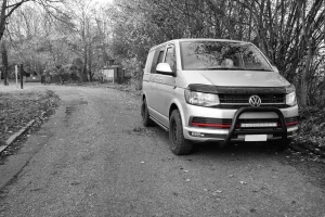

looks nice but you might have a bit of trouble with ground clearance if you want to get properly muddy! Good luck
It started with the lowering springs (bottom picture) and didn't rub or catch anything, then it went back on standard springs (top picture) and was good, but I have now sold them.
