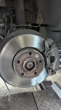

Hi All!
Hoping you can help me out if I am ordering the right parts for my T6, bought it not too long ago, but the all discs + Pads definitely need replacement.
Local garages/Dealers are too expensive if you ask me and I am getting help from an mechanic in private.
Maybe someone else in the future can also benefit from this, but would these parts be the right parts?
A question upfront;
- I assume that my front brakes are at 308mm, but when I use a VIN checker, I have 2 options, 308 and 340 diameter, apart from taking the wheel of (since it is a shitstorm outside), is there another way to be sure?
- https://www.allparts.ae/cats/?article=W ... HZJH061844
Some info about the car
Volkswagen T6 2017 TSI 2.0 (SGJ) - LWB
VIN: wv2zzz7HzJH061844
Motorcode: CJKB
Year: 2017 (2018 if you search via VIN)
Parts & Tools List
View attachment 230113 REAR - BOSCH 0 986 479 097 Brake disc Link
294x22mm, 5x120, Vented, internally vented, Coated, High-carbonView attachment 230114 REAR - BOSCH 0 986 494 583 Brake pad set Link
Low-Metallic, incl. wear warning contact, with anti-squeak plate, with bolts/screws, with spring, with accessoriesView attachment 230115 FRONT - BOSCH 0 986 479 B88 Brake disc Link
308x30mm, 5x120, Vented, Coated, High-carbon
Or could it be that I need 340?View attachment 230116
FRONT - BOSCH 0 986 494 107 Brake pad set Link
Low-Metallic, with integrated wear sensor, with anti-squeak plate, with piston clipView attachment 230117 FRONT - QUICK BRAKE 109-1680 Accessory Kit, disc brake pads Link
Only applies to the front brake set right?View attachment 230118 REAR/FRONT METZGER 11679K Bolt, brake disc Link View attachment 230119 MA PROFESSIONAL 20-B01 Threadlocker Link View attachment 230120 REAR - NEO TOOLS 11-127 Reset Tool, brake caliper piston Link
I need this for driving back the rear pistons due to the handbrake mechanism etc.View attachment 230121 MA PROFESSIONAL 20-A10 Copper Grease Link
Much appreciated!
