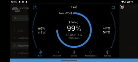

Now those menus are more familiar.Barely any difference on the beta firmware tbh, the menus are a bit less confusing, stuff is grouped. Other than that, not a lot to notice!
We're with you brother!Now those menus are more familiar.
