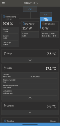

monitoring the Temps on the Shelly APP. . . a BT temp sensor stuck on the wall.
and the Victron VRM - a RUUVI temp sensor stuck to the LB.

What you using for temps... Multiple Ruuvis?. How many temps you got?
Love them Ruuvi's but they're bit on the expensive side and getting the readings to storable statistics is bit complex, doable though.
This is in the planning level but little bit later in the spring I'm going to fit a Shelly Plus 1 (love Shellys too :) ). It can be coupled with Shelly Plus Addon and then it will take max 5 DS18B20 sensors - those can be had in different wire lengths. Most of the Shelly stuff is for 240V but Plus 1 is an exception that can be run with 12V regulated power. So, internet relay control of something, 5 temperature readings and additional I/O for future growth. Also being Shelly it just integrates to Home Assistant very easily.
Yeah, 3x ruuvi tags, 1x outdoor in the fuel filler door, one for inside ambient temperature and one for the fridge. All connected to the Cerbo GX (with an additional Bluetooth dongle).
Always nice to be able to keep an eye on temps, and I'm hoping to use the inside temp to trigger a window fan via the relay function at some point.
What's the additional BT dongle for?
