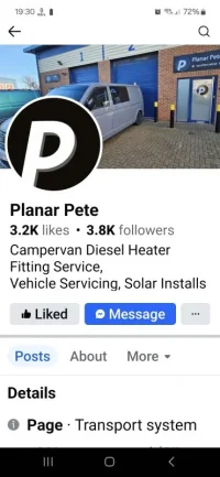

Where are you getting it fitted @Dellmassive
Taking the bus to "Planar Pete" in camberly Surrey.
A FB mobile guy recommended on here, that I've been keeping an eye on for years.
He's now got a proper unit.
He does tons of autoterm heaters in tons of T6s, he's got a T6.1 himself now by the looks of things.

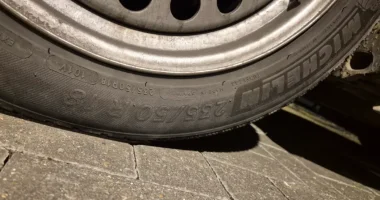

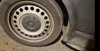

but the MOT said i needed new tyres on the rear,, - so dropping this hear for now...
looks like i have.
Crossclimate SUV 235/50r/18 101v
slight side step . . .
looks like i have.
View attachment 272693View attachment 272695
Check out Camskill too. Bought my Cross Climates from there and they sometimes have promotions of cash back from Michelin.
