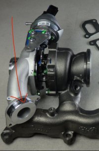

Thinking of possible pressure loss, I’ve ordered a new o ring for here, it sits just inside the hard rigid pipe the goes between here and the charge air inlet…. The o ring looks a little past its best and there is a faint trace of oil got past the o ring onto that shiny collar and the two fixing screws… not lots, but a trace amount…..
Not sure if that means turbo is leaking oil, can’t imaging it’s comes from anywhere else though …..

Engine crankcase ventilation is fed into turbo intake - side input of part 12. There is always some oil mist.
It’s not this model in your pic above, this is what Vw first pulled up today when I went to order the o’ring, it’s a 2019 model and the pipe I have doesn’t have that side inlet…..
they pulled up the right pic straight after.
It’s a daua 2.0 2019 if that helps ?
The pipe I have is long with no other inlet, it goes right up to the charge air inlet elbow….

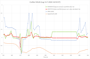

Just first sample to show where the issue is and how it looks. Now need to look how the rest of data relates to it... stay tuned...

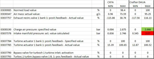

Below a comparison of a log of CXFA engine (T6.1) and yours. Only recorded minimum/maximums. So matches quite well except the pressure.
The delta in EGR position is because the CXFA run was in cold - thus the EGR cooler is most of the time bypassed, hence mostly negative values there for CXFA.
The deep dip in IDE07376 intake manifold pressure (0.545 bar) is because engine was stopped by Stop/Start at 171 seconds (ECU closing intake airways, thus choking the engine)

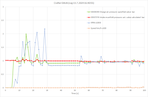

Well, a bit confusing part is that specified pressure steps up on idle to 1.35 bar - here above from 208 to 236 seconds. Haven't seen that behaviour on other engines. Perhaps it designed to do that, or is it doing a self-diagnosis there.
On the first log that "boost request" didn't happen, see below engine start-up from 0 to 10 seconds. Also on ticking over from 32 to 53 seconds.
