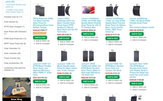

i got the 220W kit which was 2x 110W black ETFE panels.
similar to these . . .
but they have loads of options:
for the van roof I've acutally got one of these but not fitted it yet . . . .as i liked the idea of rear cable gland . . .

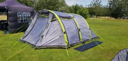

one of my lensuns on the roof this morning . . .
