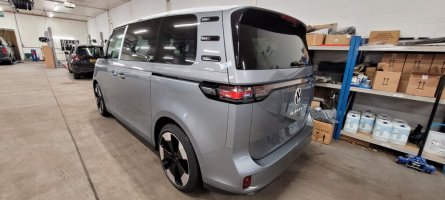

We are removing the rear suspension tomorrow to tuck the wheel to will report back on measurements - What I will say on the standard wheels there is a good 35 mm inner clearance

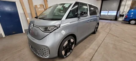

In the meantime here is a picture we took today
