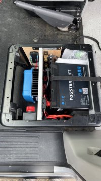

You will struggle to get all 3 components under a single seat with heater pipes there too. Potentially possible if the leave lots of room and you use the new Victron 50a DC-DC as it runs cooler so doesn’t need as much space. I’d recommend putting some under your passenger seat and running the cables across (dead easy). Pic below to show my under passenger seat instal with 105ah Fogstar, Orion DC and Ablemail.

The 18a DC-DC is a little smaller and runs cooler so may fit under the drivers seat. The only way to tell is to remove the seat and lay it all out to see if they will fit. The same with the passenger seat if you need to use under there. The swivel won’t stop you but may limit the height available depending on the model of swivel (I have swivels on both seats).
I would run new cables if at all possible. The one from the starter battery is pretty easy through an existing grommet (you will be able to see it down behind the battery - probably with the existing cable through it) and under the cab floor covering. It’s easier if you take out both seats and bases and pull the floor back to access everything. That sounds difficult but is only a few bolts and takes about 20mins. You would then be free to position stuff exactly where you want it under the seats and easily run the cables (there are indents in the floor running in all directions for this).
