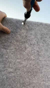

Pretty chuffed with myself :cool:
But I haven’t managed to put the holes back through yet. Any tips?
I saw someone else say they pushed a hot screw or allen key through. Bit nervous to try it but if that’s the best way then so be it.
If you're planning to use the soldering iron for any actual soldering later, don't use the same nib to burn through the carpet. It melts the carpet fibres and sticks really hard to the iron, makes a total mess of your nib. When opening the carpetted holes on the metal parts of our van, a quick buzz with a countersink drill bit did the trick. Don't know how well it would work on the board panels but was great on the metal holes.

I cut the holes with a Stanley knife. Takes a bit to patience but got the result.
On the back of the panel you can just cut out a square of the carpet.
Needs a sharp blade, the carpet takes the edge off quite quickly.
I think my stanley must be quite blunt. I'll add a new blade to my ever growing shopping list :)
