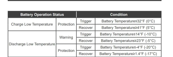

【Low Temperature Protection Function】 The lithium battery has low temperature charging and discharging protection function. When the temperature is below 0℃, it will stop charging. When the temperature is below -20℃, it will stop discharging.

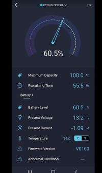

【Real-time monitor】 Monitors the battery operation status on mobile devices in real time with the built-in Bluetooth module.

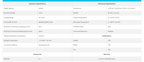

so . . . what this one about?
well the stats say:
100Ah Capacity
100A max discharge ( -20~60°C )
Low Temp protection ( yes - 0-5DegC)
50A max charge ( 0~55°C )
its IP65 water resistant,
2000-8000 charge cycles
integrated BT,
intergrated BMS
SLEEP MODE after 24hrs
Lithium Iron Phosphate (lifepo4) chemistry,

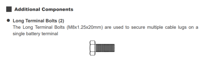

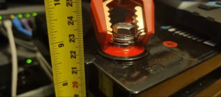

bolt size and pitch: Bolts (M8x1.25x20mm)

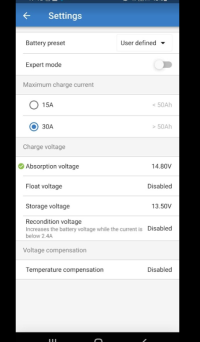

Charging:
During the standard charging process, the battery is first charged at a constant current of 30A
until the battery voltage reaches 14.4V. Then, the battery is charged at a constant voltage of 14.4V while tapering the charge current.
The standard charging process is considered complete when the charge current is less than 5A. However, leaving the battery on float will continue to balance the battery cells and will not damage the battery. The standard charging process normally takes 3.5 hours. Safe charging requires battery temperatures between 32°F and 131°F (0°C and 55°C).

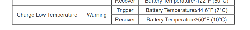

low temp protection:

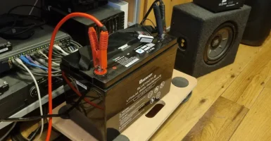

So, thats the official word . . . Heres mine.

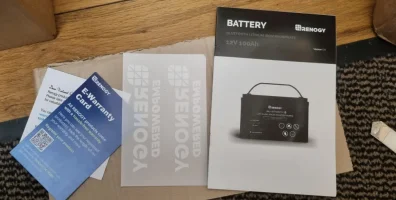

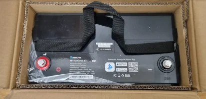

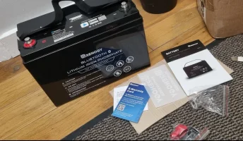

it comes very well packaged as the Renogy kit normally does . .
included are manual, stickers, warrenty card, second set of longer bolts plus terminal covers . . . plus a detachable carry handle.

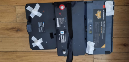

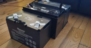

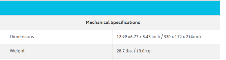

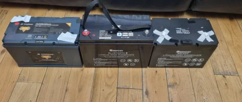

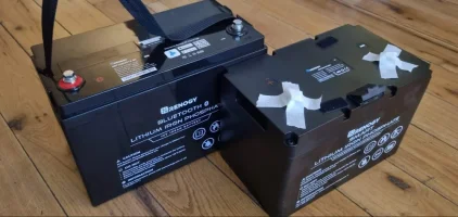

out of the box . . . the first impressions are ITS BIG !!! and very LIGHT.
normally with the light battery's you get the pouch cells - like the POWEROAD. (instead of the heavier 18650 cells or CALB style cells)
have a look at the compairson on size between the other Renogy SMART and POWEROAD 100Ah Lifepo4 batterys. . .
not sure why on the size . . . . maybe to fit the USA standard Group battery size thing? - duno.
but it hasnt got the boltdown lower lip anyway?
moving on . . .

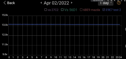

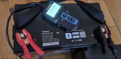

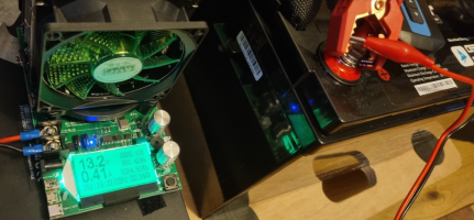

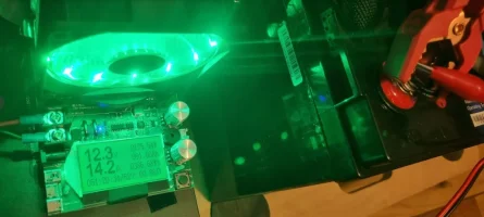

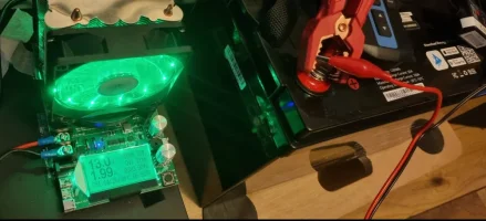

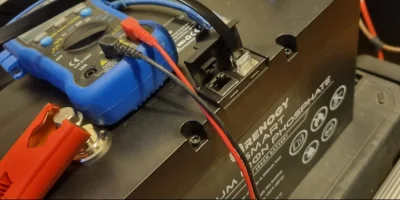

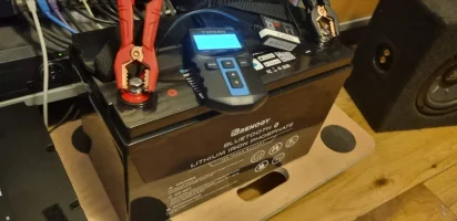

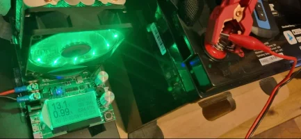

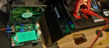

out the box the battery was showing 13.17V. . . . which i thouhght was odd. . .
as the battery should have been sleeping by now - during shipping ( < 1A / over 24hr = sleep mode )
so . . . ill have to test further. . .
when the POWEROAD goes to sleep the voltage drops to 8v or so . . . (monitoring voltage)
The other Renogy SMART battery has a manual SLEEP button that needs to be pressed (but who needs to SLEEP there battery anyway? in the UK we dont normally store the vans for long periods)
