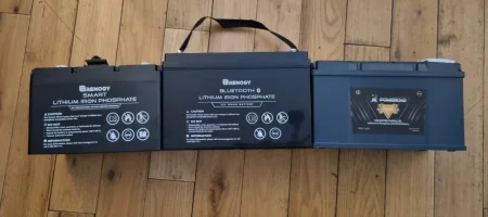

out of the box . . . the first impressions are ITS BIG !!! and very LIGHT.
normally with the light battery's you get the pouch cells - like the POWEROAD. (instead of the heavier 18650 cells or CALB style cells)
have a look at the compairson on size between the other Renogy SMART and POWEROAD 100Ah Lifepo4 batterys. . .
not sure why on the size . . . . maybe to fit the USA standard Group battery size thing? - duno.
but it hasnt got the boltdown lower lip anyway?
