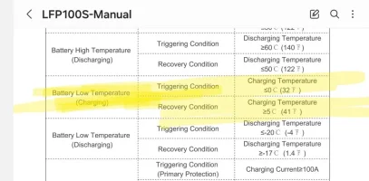

Low temp protection kicks in at 0c.
And released at +5c.
It's detailed in the user guide.
Yes, I noticed that from the info @roadtripper referenced, but I'm not aware of anything that would prevent charging below 0C.

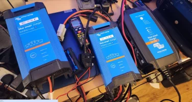

i have two vic IP22 BSC,
one is HW Rev1 and one is HW Rev2 - and as you say the Rev2 has the "VE.Smart" BT networking.
but afaik the IP65 BSC version do not have "VE.Smart" BT networking.
there isnt a IP65 BSC rev2 listed in the demo library.
do we know what version @Bav has? ip22 or ip65?
It's the IP22 version. How do I tell if it's Rev1 or Rev2?
HW V1 or V2?
v2 version has the VE SMART section.
like this. ( the V1 doesn't have that bit)

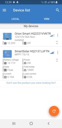

you can check via serial number range as well,. . . . but would need to check at what point they swapped over.
The VictronConnect app only shows the solar and DC/DC chargers - the BSC doesn't show at all...
Switched on at the mains? (It needs to be for the app to work)

As I sit in my front room, the app doesn't show any Victron components, so I presume the app communicates over Bluetooth and I'm out of range.
Sorry, I'm a complete dummy when it comes to all things electrical! Ok, so I need to be on EHU for the BSC to talk to the app - makes sense I guess. I'd best check battery temp is > 0C before hooking up then!!!
Yes you need to be within Bluetooth range of the devices and the charger needs to be powered on at the mains. If you isolate the battery switch and turn on the mains charger, you will be able to connect to the charger via BT without charging the batteries.
