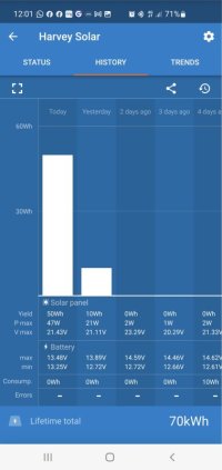

@Dellmassive @Higgidav. Cheers for your comments above in response to my earlier post #842. With the rising temperatures here in Glos, everything seems to be back to normal now BUT it didn't start to charge again until it hit 10° this afternoon (and we've been over 5° pretty much constantly since yesterday PM). In hindsight, I suspect that it might well have started to charge had I thought to switch the Victron Bluesmart off and on again some time earlier today.

Although I said in my post that I thought the charge might have been kickstarted by switching the Victron on and off, I reckon that starting the engine (ie. switching the Ctek D250SE on and Victron off) might have had the same effect). That said, I'm kind of surprised that yours started charging on the drive into Brum when it was still only 1° as the manual as posted by @Dellmassive above indicates over 5° as the tipping point. Maybe the ambient temperature in the van was up enough but what do I know!

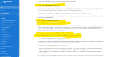

the Orion doesnt have a temp sensor - ? how did you check the 5c setting?
unless you are using a BMV712 or battery sense and broadcasting a local VE-Smart?
same with the vic MPPT, but it has a basic internal temp sensor, that it uses for SLA voltage compensation.
so neither of them have the lithium low temp blocking - unless you have the external temp sensor.
3.10.2. External temperature and voltage sensor​
The (optional) Smart Battery Sense is a wireless battery voltage and temperature sensor and can be used with the solar charger. It measures the battery temperature and the battery voltage and sends this via Bluetooth to the solar charger.
The solar charger uses the Smart Battery Sense measurements for:
  • Temperature compensated charging using the actual battery temperature, rather than the solar charger's internal temperature. An accurate battery temperature measurement will improve charging efficiency and prolong the life of lead-acid batteries.
  • Voltage compensation. The charge voltage is increased to compensate in case there is a voltage drop over the battery cables during high current charging.
The solar charger communicates with the Smart Battery Sense via Bluetooth using a VE.Smart Network. For more detail on the VE.Smart network see the VE.Smart Networking manual.
Alternatively, a VE.Smart Network that measures battery temperature and battery voltage, can also be set up between a solar charger and a BMV-712 Smart or SmartShunt battery monitor that has been equipped with a Temperature sensor for BMV, without the need for a Smart Battery Sense.
The important thing to note is the hysteresis.
Charging is blocked if temperatures drop below zero. That block is released when the temperature climbs over 5.
So it's still entirely possible to be charging at 4 or 1 degrees - just means the temperature hasn't crossed zero and been blocked.
Why is this done? It's very common in control systems as you don't want things flipping state backwards and forwards as the accuracy of a reading moves around maybe several times a minute so you tend to define it as "once a system is in state A it needs to definitely have moved far enough to be in state B"
