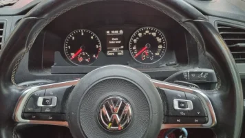

where did you send the wheel too ? Do you have a part number of the chips ? ThanksThis is my wheel. I don’t have any chips from the old wheel as it wasn’t a MFSW ? Are your lights on the steering wheel white or red ?
White.This is my wheel. I don’t have any chips from the old wheel as it wasn’t a MFSW ? Are your lights on the steering wheel white or red ?

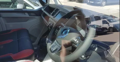

Ok, do you still have the casing from the original switches? I’m trying to find a T6 setmy van is a OEM 2018 Sportline
this is the MFSW supplied with the van from factory.
to get the golf Mk7 wheel (buttons) to work i had to send it off to the place @Insert Coin found to get them to do the electronics wizardry to remove and replace the chips from the original wheel buttons into the MK7 buttons. . .
thats so the buttons will comunicate with the van etc.
the flappy paddles would work ok,
and i think the horn worked ok.
but as above a standard Golk Mk7 will not work on a T6,
you need to send it off to be worked on. . . .
there are now a few places that offer a swap service, or send yours in to be modified etc etc .
I've seen a few dotted around Facebook etc . . . .
normally the places that do the LED colour changes / reworks as you need the proper solder hotair station and some serious skillz working with those tiny components.
