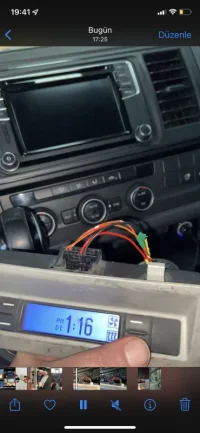

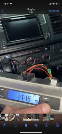

Today i finaly find a shop with some roof modules and tried all off them :)
As all we know module with suffix g works flawless
Module with suffix f conmects the vehicle but can not start webasto nor ventilation
(Maybe it can be flashed to g firmware because able to get system time)
Even i tried a very old module and suprisingly it cranks heater and ventilation but no mode or set functionality ( can not get the system time)
