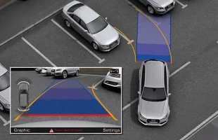

Guidance lines on my T6 OE rear camera are static, won't turn with the steering input of the vehicle, so not sure what your on about @Andrew Todd ?
IMG_6462.JPG On my Q7 as you turned the wheel the guidance lines moved to show you direction of travel, just like the attached image. Do the T6 cameras not do the same?
Yes the camera will work, thats the same unit i have in my van and have already added a camera to that (Y)
