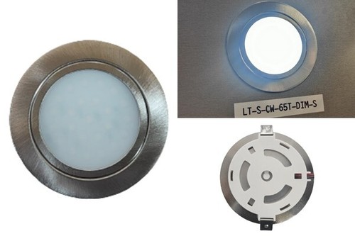

I’m looking to install some down lights around the HiLo in the soffit. I know there are a lot of shallow cabinet lights (circa 70mm) but was looking for something a little smaller, around 40mm.
Has anyone found anything smaller than the typical ones?
Thanks in advance,
Sorry should have said diameter of the light... I worked out I will have about 50mm to recess through the soffits but trying to find something small in its diameter.
thanks guys.
I used these and they have been really good, available in a few outputs. No spring clips and only need a recess of about 15-20mm. They have a rubber part on the back that grips into the hole.
I wanted something a bit smaller than the larger style ones that are more common.
You can see the output of them here, this is a Hilo too. We have 7 in the sides and two in the tailgate.
