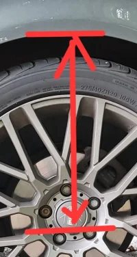

Can anyone offer feedback please? I like the swamper look as much as I like the sportline look. My van has been sportlined (it's a highline) but it looks like the mrs is worried about curbing the pristine 20's when she drives it, so am thinking I'll get some high tyre walls... the van is lowered... not sure what to do. Will a set of swampers fill the arches too much and rub? Not sure how adjustable the (cheap) coil overs are either

Best way to start use to measure from the wheel centre to the top of the arch, front and back, that'll tell you/us how much it's been lowered by.
235/65R17 tyres and wheels are good down to 50 or 60mm drop, I believe. So there's plenty of scope.

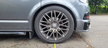

Well that's my next oddment or peculiarity. The height seems to vary depending on where parked to the extent I can't figure out how dropped she is. See photo.
Yeah I put tape measure down to ensure i took a photo of each wheel the same distance as a vague comparison but it'snot very clear... i dunno why. I looked a plank no doubt hehe
The photo below is the measurement frombthe wheel arch to the bottom lip of the centre cap

I reckon you'll be perfectly fine with 235/65R17 - if your tyres are 275/40R20 then they're only 8mm smaller than 235/65R17's. 4mm arch gap loss and 4mm ride height gain.
Take off 20mm from your measurements as it's to the centre of the wheel, but that looks to be around 50 or 60mm down from std at the front.

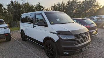

Here's my Swamper. Due to take delivery on the 30th and time has slowed to a crawl.
The rims are Wolfrace Outland's in 16" flavour, and the fat sidewall and Cooper AT tyres soak up the horrible British roads beautifully.
It has the arch trims and black chrome side bars, and I already have a set of mudflaps ready to go on when it arrives on Friday.
I've some ideas to butch it up a bit, including a lift, snorkel, grille spots and side mouldings, but I'll live with it a few months before deciding what would suit it best.

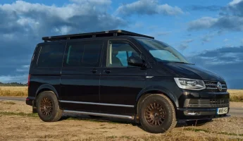

I didn't fancy chrome side bars, so went for a more useful solution....... rocksliders
Ouch, bet they weren't cheap! TBH if I'm bottoming the van out over some rocks I've taken a very wrong turn!
You're right, not cheap, but I do a fair bit of soft-roading along Scottish forests and tracks. Had these fitted, because I'm the guy that would turn in to a hidden rock or tree stump. Also had Almont sump, fuel & Adblu tanks and rear diff guards fitted. Really came in to their own on Orkney, Arran and Mull
