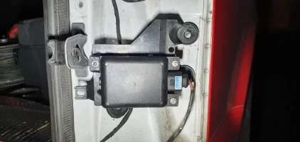

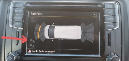

These 5Q0 radars perform auto calibration so any position imperfections are going to be compensated by the software anywaysRober that looks great.
How did you find the right position ?
And can you share a drawing which shows where to drill a hole ...
And the length of the Three thingees

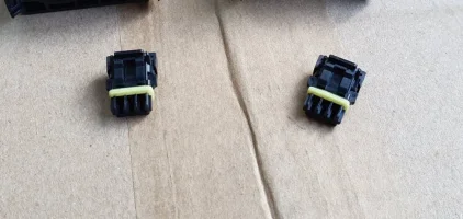

Also there are total of 12 connectors N10335706 in these 2 plugs 1J0973714@Robert: can you please tell uns the VW Part-Numbers of the Plugs for the LED Modul and for the 5Q0 Modules?
Thank you!
There you goThank you @Robert !
I think I have the OEM Number for the LED Plug. I will post it later after testing.
Do you habe the Pinout from the 5Q0-sensors?
Actually there are 3 pins on each OEM mirror LED. Middle one is not in use.Thank you @Robert !
