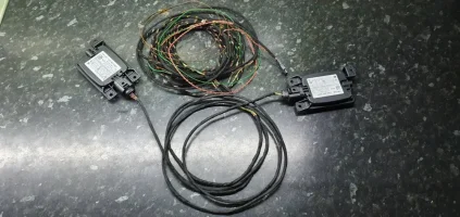

Good idea and also this might be helpful for youJe pense que je vais acheter ce kit. J'adapterai le support des portes arrière.
https://translate.google.com
Looks interesting, shame the mirror glass wont fit.This link works for me and the kit looks good.
For €228.23 I wouldn't hesitate![]()

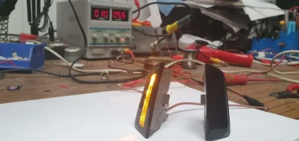

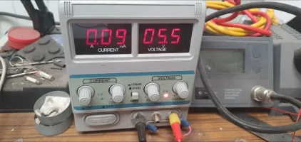

Perhaps just using a zener-diode to create a constant voltage drop would do the trick.The voltage needs to be reduced from 12V DC to 5.5V DC so why not use a DC voltage converter
I am experimenting with "buck converter", "linear voltage regulator" and few other similar converters
to see which one is going to replicate the voltage in the best way.
Basically I would like to keep that slow fade in and slow fade out effect on my new 5Q0 radars
This sounds like a good idea.Perhaps just using a zener-diode to create a constant voltage drop would do the trick.
I think e.g. a 8.2V/1Watt zener might suffice as the light is not continuosly lit. Is the current draw of T6 LED 0.10A - as on your picture? That would cause 0.8W momentary load on diode. Possibly a resistor in series to limit the current just in case...
