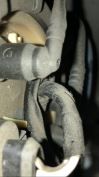

Needing some help please… I wanted to check tonight to see if I need to order a pick up pipe for my 21 plate T6.1 panel van or if I have the sacred nipple.
I managed to get sight of the fuel pump and it looks like I do, but there’s already something connected to it? I ordered my van new and can’t think what it could be and how I go about tapping into it.
Any help would be great! Photo isn’t great as it’s a screen shot from a video.

Well - there is certainly a connector on your 3rd nipple!
Are you sure that you haven't got a heater installed anywhere? That looks like a fuel connector and not just a blanking one.
I would be inclined to get a tee connector ready to clip to the sender unit and just re-connect that odd connector back up, that way it will still function the same. I really can't see why there would be a connector on there with no heater fitted. Have an ordinary elbow ready also in case that connector is redundant.
Maybe someone has started an install in the past - any chance of tracing that pipe to see where it goes? You may find the other the other end is just blocked off.

Positive! This is the spec I ordered and it’s never been in the hands of anyone else. I’m wondering if the 80L tank as something to do with it?
I was thinking that but I don’t think they’ll be enough space to tee off there due to the angle of the connector. I’m going to have to trace down the pipe as it doesn’t make any sense.

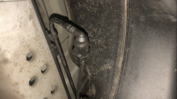

I have this at the rear, not sure what it could be?
That must be connected to something! I would have thought that you could tee off that connector though ( whatever it is for ), I can't think what else would need to take fuel from the tank other than a heater.
Plenty of room for a tee for either end - TTM789ID6 - T-Type 4 6mm 8mm 10mm Quick Connect Disconnect Release Fuel Line Coupler Hose Connector | eBay
You will also need a 8mm to 5mm pipe joiner as there doesn't appear to be a 8mm/5mm tee in the Bundy fittings that I can find.
I wonder if the factory just added that extra take off as a matter of course to a particular run of builds but I would expect to be able to access the end of it somewhere fairly easily.
I’m not going to be able to sleep at night now haha wish I could just drop the tank.
That looks ideal thank you! I’ll get that ordered but definitely going to trace down the pipe. I’ll report back with my findings haha.

send me your vin i will have a look and see if i can see anything
So I have have a aux heater by the looks of it, noticed the small little exhaust at the front. Looks the same as below. Makes no sense to me haha
Confirmation I’ve got a factory aux heater fitted without being spec’d or door sticker.
