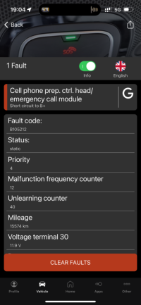

i have something like this. vw dealer doesnt know what this mean. they change already module and error still there.
I'd try another dealer then as that fault is about an issue detected in the power supply to the module - short circuit to B+ (battery positive) - likely a fault in the wiring.
