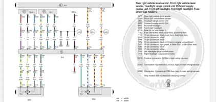

Now I am bravely moving to 2nd part, installing auto range control. I have ordered all the parts but I'm stuck at wiring diagram. Partly because I can't read the numbers due to low picture quality and partly because I am not sure if I understand it correct. I made a list with pins for wiring and would kindly ask if you guys can check it and make it complete, please.

Is this any help?

Hi Robert.
Thanks for reply. Sure it helps by showing how to wire range control unit with headlights and it helped me a lot in first part. But I still need part where shows how to connect range control module to both level sensors and BCM pins. Maybe you can post more clear wiring diagram for range control unit from page 9, so I can read the pin numbers?
Hi Robert.
Thanks for reply. Sure it helps by showing how to wire range control unit with headlights and it helped me a lot in first part. But I still need part where shows how to connect range control module to both level sensors and BCM pins. Maybe you can post more clear wiring diagram for range control unit from page 14, so I can read the pin numbers?
There you go :).
