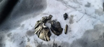

I found this inside of my turbo cold side.

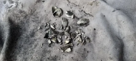

And this is what I have flushed out of my intercooler.

My turbo also blew up and it only happened last Friday night.

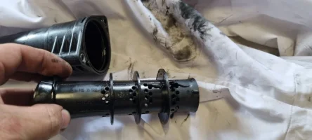

Pipework between my turbo and the intercooler also got damaged.
Is that what's left of the impeller? Christ, mine didn't look that bad.
What power is yours?
Yes, my first 2 photos above show my cold side impeller(all of these bits).
My bus is 2016 150PS and I got it remapped to 190PS back in 2017.
Long story short, I have already purchased revised version of turbo (factory brand new unit) last Monday and got it installed myself.
Test drive also performed(2200km = 1367miles)
No oil consumption observed so it appears that my intercooler not only survived but also saved my engine.
I might put up my own thread and explain everything in detail.
