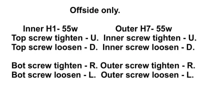

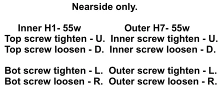

Bingo! Managed to put the bulb in the right way up and found those two screws to adjust the angle- have dialled them down a bit. Do these adjust the angle of each lamp up and down? One for main and one for dipped? Think I’ll go with the wiring harness solution for dipped + main..
If I remember correctly, there are two adjusters on the dipped and one on the main.
The inner one on the dipped is vertical and the outer is horizontal.
I think the main is just up and down, but will look again in the morning.
If you park a few metres from a wall at night, you can easily see the movement..

D7E7D65F-1B09-45A1-8536-9F492D48F7BC.jpeg A094545F-2E2F-4D88-A0DA-9C39F6FBF6C9.jpeg
I put some labels on the top of my THQ V2s before installing to avoid trial and error or using a mirror to read lettering on the back of the casing.
