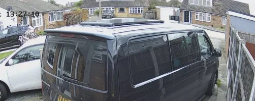

And then I offered up the panel on the roof - it sits much better across the ridges now but I’m undecided whether I like the looks of the panel on the roof from side view and from the front - even taking into account the black panel, black aero mounts and black van.
But I’ve bought it now and mullered the aero brackets so can’t return it
