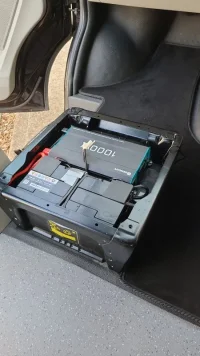

Fitted a new AGM battery and invertor. Also wired the heated seats (via an igntion on relay), dash cam and tracker to the auxiliary battery.
Hoping it won't get too hot. It has a thermal cutout so I can monitor it.
