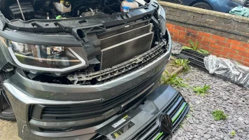

my job tomorrow hopefully weather permitting is to fit the same headlights as yours, so I’ve watched a few videos on bumper removal, is it simply enough ?
any chance of breaking any clips as that is my worry

Not really , the hardest clips to remove are the two that hold the bumper sides together ( the ones that you have to peel the black liner back for , I normally just squash them out and replace with new clips
Other than that follow the thq video and you will get there in the end
My advice would be to test the lights and beam pattern before you put bumper back
