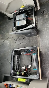

Not mine, but fitted a Renogy 40a dc-dc and a Fogstar drift into my mate’s T6.
All the 12v to put in still and a bus bar etc, but needed to get to this stage so a diesel heater can be fitted.
Restricted the Renogy to 20a (Fogstar recommend 20-30% of capacity as max) and it all works a treat.IMG_5875.jpeg

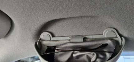

Somewhere to put the sunglasses at last!!! It's the small things! No bracket so I made a 6mm marine ply template and screwed into that behind the headliner. Doesn't need to carry weight and works perfectly.

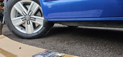

Washed it for the first time in ages.
I need to get this thing ceramic coated, even a 'quick' wash took well over 2 hours...
It doesn't need a full correction, just the worst taking out (TBF, there's a lot that needs correcting) as it'll no doubt get subjected more scratches over time. Just need it to be much easier to clean!
