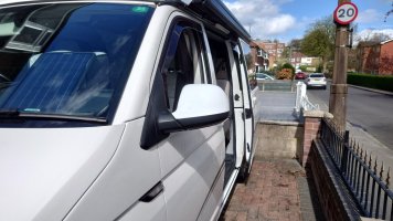

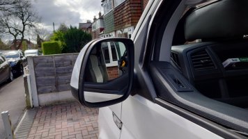

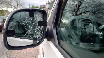

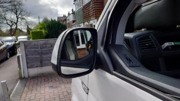

Last week I fixed the mirror.
From this:
To this:
Aftermarket glass which seems fine and was about 13 quid;
OEM lower cap, about 20 pounds;
And aftermarket top cap from Ebay, again 20 odd. I presume 3D printed, reasonable colour match but you can tell if you look closely.
Not sure if it is the poorly fitting top cap or damage to the internals but it didn't go smoothly, it doesn't sit quite right and isn't fixed in properly, but it's good enough.

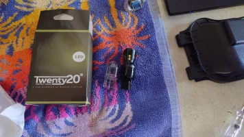

Today was the DRL.
I managed to find a brand new OEM RHS H7 from Deutschparts, with some damage but functional. A bargain, and only a tiny chip off the extreme corner is visible once fitted.
I wouldn't have a hope in hell of soldering the new DRL holder on to my older H7, so this was my only option.

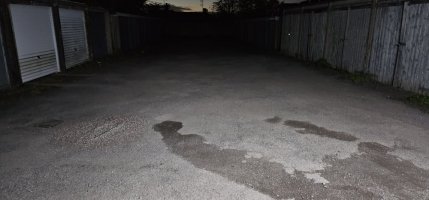

Took the opportunity to install Twenty20 LEDs.
Picture shows the new LED on driver side, and Maruta whiter halogen DRL on the other.

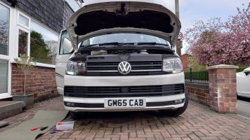

Following advice on Andy Smee's excellent Guide thread, I didn't fully remove the bumper and was able to swap the headlight, bit fiddly but doable.
The new one looks really shiny compared to the old! Starting looking for a LHS one now in case the DRL holder on that side also fails.
Picture showing OEM DRL bulb and the LED.
I should have taken the bumper off anyway, as it was impossible to fit the LED into the LHS H7, with the holder, presumably because it was too long.
So grill and bumper undone on the other side, light out, managed to get the LED DRL installed *without* the lever thingy, test fitted and of course didn't work, so reversed the LED and it worked. Hoorah!
Connected up the DRL lever thingy, light in, quick check, not working! Started swearing under my breath until I remembered I hadn't plugged the loom in, Hoorah! Two LED DRLs!!

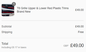

Bought some more, but at the same time, from the same company.
The others will be taken off & kept as "spares"
Probably end up on this list:
Or sold to another forum member at an upcoming Forum meet for 1/2 the price I paid!! :D
