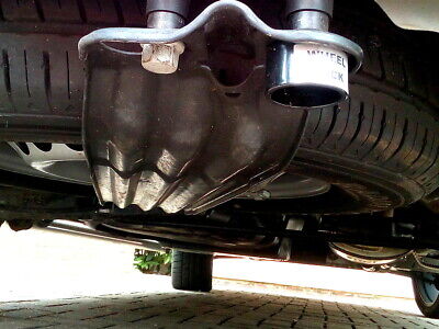

Finally fitted the locking wheel nut and security shroud to the spare wheel holder :waving: - only took 10 months to get around to it. :rolleyes:

Is that the SpareSafe you've installed. If so, I'd be interested to know whether there were any issues with the detachable towbar - I thought I read somewhere the two weren't compatible, hence why I've held off fitting (and fortunately I still haven't lost the wheel).
Sorry, no - it was just a locking wheel nut, with a protective shroud that I bought separately.
EDIT: The wheel nut was from campervanbits.com and this is shroud...
I have one fitted with an OE detachable towbar and no issues.
Also copper greased the bolts when I fitted it so no issues when I had to actually get the spare of in The Pothole Incident
